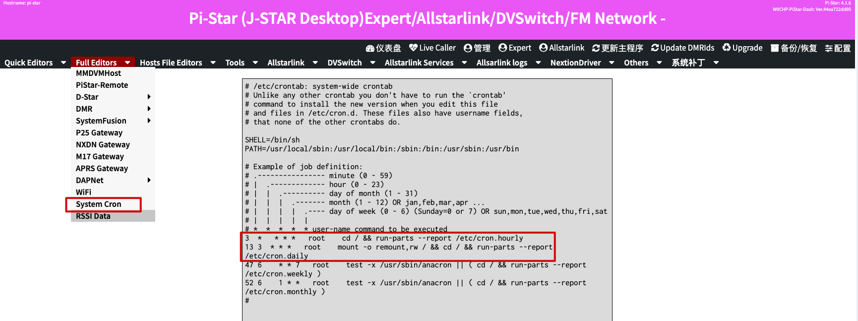

故事很长,先从PI-STAR的定时任务调度,说起吧。
http://192.168.31.37/admin/expert/fulledit_cron.php
# /etc/crontab: system-wide crontab
# Unlike any other crontab you don't have to run the `crontab'
# command to install the new version when you edit this file
# and files in /etc/cron.d. These files also have username fields,
# that none of the other crontabs do.
SHELL=/bin/sh
PATH=/usr/local/sbin:/usr/local/bin:/sbin:/bin:/usr/sbin:/usr/bin
# Example of job definition:
# .---------------- minute (0 - 59)
# | .------------- hour (0 - 23)
# | | .---------- day of month (1 - 31)
# | | | .------- month (1 - 12) OR jan,feb,mar,apr ...
# | | | | .---- day of week (0 - 6) (Sunday=0 or 7) OR sun,mon,tue,wed,thu,fri,sat
# * * * * * user-name command to be executed
3 * * * * root cd / && run-parts --report /etc/cron.hourly
13 3 * * * root mount -o remount,rw / && cd / && run-parts --report /etc/cron.daily
47 6 * * 7 root test -x /usr/sbin/anacron || ( cd / && run-parts --report /etc/cron.weekly )
52 6 1 * * root test -x /usr/sbin/anacron || ( cd / && run-parts --report /etc/cron.monthly )
每天定时任务:/usr/local/sbin/pistar-daily.cron
触发时间:13 3 * * * :凌晨3点13分执行,主要任务:清理日志,更新DMRID,服务器列表
